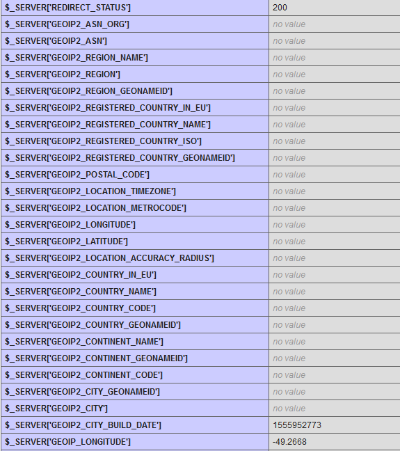

    Didn't touch anything at all....But after the PHP 7.3.5 upgrade this morning I noticed the bad php.info after some hard work :(

    did you answer yes to overwriting php.conf/php-fpm.conf file again ? ;)
    in your /root/centminlogs the latest php_upgrade log would have listing record of the php-fpm.conf backup file name you can restore
    command below with grep case insensitive match the keywords in the very last php_upgrade.log log (most recent) if you answered yes to overwriting the file
    grep -rin 'Backing up existing' $(find /root/centminlogs/ -type f -name "*_php_upgrade.log" | tail -1)
    example of modified grep keyword to match the word overwrite
    grep -rin 'overwrite' $(find /root/centminlogs/ -type f -name "*_php_upgrade.log" | tail -1)
    28:Want to update to latest php.conf ? (overwrites will auto backup existing php.conf)
    31:Update & overwrite your existing php.conf [y/n]: n
    technically that should ask if you want to overwrite php.conf and php-fpm.conf

    No, this time not. Learned my lesson the other time. If I did that the GEOIP 2 didn't show up in the phpinfo.
    I noticed more items with "NO VALUE" than before.

    GEOIP2 fastcgi_param settings still in /usr/local/etc/php-fpm.conf or gone after update ?

    Well, all php-fpm.conf were gone. Wanted to show it but yeah, woke up at 02:00 AM and did cat > /usr/local/etc/php-fpm.conf..... instead of cat /usr/local/etc/php-fpm.conf.... little typo. ;) So, file empty..
    But it had the old date, and it was missing the GEOIP 2 items.
    And I edited my post just before yours and you can see that I did not press "y".
    First gonna revert the situation to the php 7.3.4 and the correct the /usr/local/etc/php-fpm.conf file and DUBBLE check that the GEOIP 2 shows up into my php info file.
    After that I will update again, check it and post if nessesary the files you asked at gist.github.com.
    So, better take a little nap now, and do my tasks to check if its a bug or not.

    yes that would of emptied your php-fpm.conf file !
    if you did in past answer yes to overwrite, there would be backups date time stamped so if there are recent enough, you can restore php.conf and php-fpm.conf from those backups

    Thanks, but already did that and my GEOIP 2 info is back again. But gonna test it anyway, downgrade to 7.3.4 and upgrade to 7.3.5. to check what happens with the /usr/local/etc/php-fpm.conf.

    Well, I did a down/upgrade and nothing changed. GEOIP 2 works so I wonder what went wrong. I can't reproduce what happend, so for a final test, I am going to use a snapshot that I made yesterday and try it again on a new droplet because there were also some other updates that I did before I upgraded PHP

    check whether or not the geoip2db-update.sh cronjob (used to update geoip2 lite database) was run since the php upgrade that you saw GEOIP2 values disappear in phpinfo output

    Yep, Just before that I updated the PHP.
    grep 'geoip2db-update.sh' /var/log/cron
    May  2 02:20:01 server6 CROND[26293]: (root) CMD (/usr/local/src/centminmod/tools/geoip2db-update.sh >/dev/null 2>&1)
    But alreay saw a fix that you made.
    Date:   Fri May 3 18:48:56 2019 +1000
        update tools/geoipdb-update.sh & tools/geoip2db-update.sh in 123.09beta01
        ensure nginx and php-fpm services restarted on script runs to update geoip legacy and geoip2 lite databases

    yeah updated 123.09beta01 with fix for that - when the geoip2db-update.sh cronjob runs to update geoip 2 lite database it seems nginx/php-fpm need a service restart for it to be able to read the updated geoip2db-update.sh database. I came across this when I setup my geoip2 lookup site at https://geoip.centminmod.com/v2/ the fields would go blank after geoip2db-update.sh cronjob ran and updated geoip2 lite database. I fixed it on my site but forgot to add fix to centmin mod :)

    should be resolved if it was geoip2db-update.sh related
