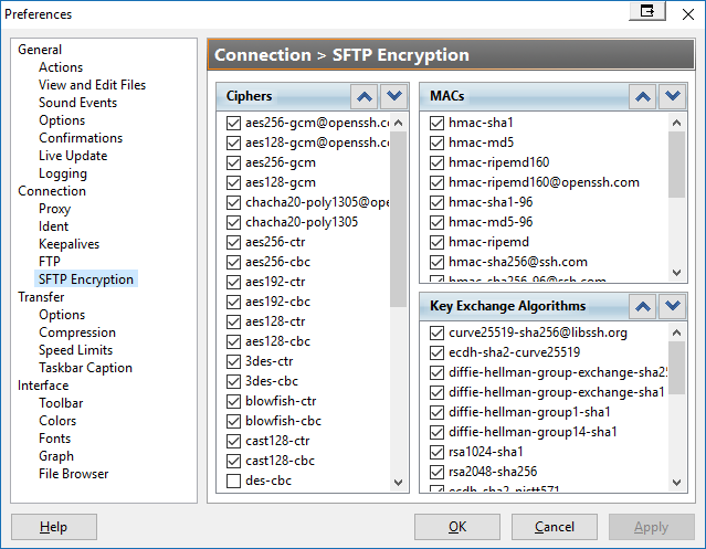

    tried updating to FlashFXP 5.4.0 ? Are you using CentOS 7.4 ? when did you update from CentOS 7.3 to 7.4 ? I see your logs trying to connect via SSLv3 which i think was deprecated in CentOS 7.4
    [R] Connected. Negotiating SSL/TLS session
    [R] 150 Accepted data connection
    [R] SSLv3 negotiation successful...
    [R] SSLv3 encrypted session using cipher DHE-RSA-AES256-SHA (256 bits)
    [R] Data Socket Error: Failed SSLv3 negotiation, disconnected
    tested with FlashFXP 5.4.0 on CentOS 7.4 based Centmin Mod
    [18:01:46] [R] MLSD
    [18:01:46] [R] TLSv1.2 negotiation successful...
    [18:01:46] [R] TLSv1.2 encrypted session using cipher ECDHE-RSA-AES128-GCM-SHA256 (128 bits)
    [18:01:46] [R] 150 Accepted data connection
    You may need to change order of ssl ciphers used in FlashFXP
