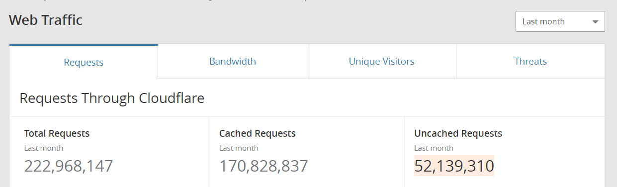

    So with my 1 month stats:
    I would be paying $260 USD if I have it enabled the entire month :eek:.

    52,139,310 - 10,000 (free) = 52,129,310
    52,129,310 / 10,000 = 5212.931
    5212.931 x 0.05 = $ 260.64655

    Wrong calculation rate limiting is per request processed through rate limiting rules iirc Billing for Cloudflare Rate Limiting

    Yes, and my Rate Limit rule cover my entire site previously (www.example.com/*).
    Rate Limiting also doesn't count request that is HIT/Cached on Edge (only count Uncached Request).

    interesting no where in their doc/pricing info do they mention that part. Cloudflare support confirmed this ?
