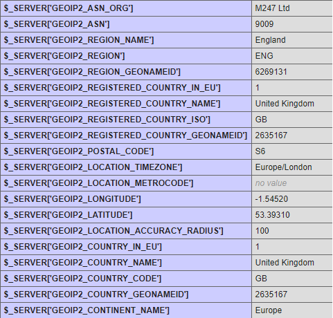

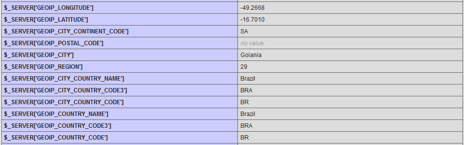

    Followed the https://community.centminmod.com/threads/how-to-enable-geoip-2-lite-nginx-module-support.17165/ step by step and verified all settings and links.
    lsof -p 6897 | grep .so | grep geo
    nginx   6897 nginx  mem       REG              253,1    96056 42503429 /usr/local/nginx/modules/ngx_http_geoip2_module.so
    lsof -p 6897 | grep GeoIP
    nginx   6897 nginx  mem       REG              253,1  6470616  9210863 /usr/share/GeoIP/GeoLite2-ASN.mmdb
    nginx   6897 nginx  mem       REG              253,1 61366615  9074935 /usr/share/GeoIP/GeoLite2-City.mmdb
    nginx   6897 nginx  mem       REG              253,1   197136   255101 /usr/lib64/libGeoIP.so.1.5.0
    nginx   6897 nginx    6r      REG              253,1  1242574  9046934 /usr/share/GeoIP/GeoIP.dat
    nginx   6897 nginx    7r      REG              253,1 20539238  8435135 /usr/share/GeoIP/GeoIPCity.dat
    I have commented out the last line in
    # SET the path to the .dat file used for determining the visitors country from the IP-address ###
    geoip_country /usr/share/GeoIP/GeoIP.dat;
    geoip_city /usr/share/GeoIP/GeoIPCity.dat;
    # GeoIP2 Lite databases
    include /usr/local/nginx/conf/geoip2.conf;
    to include the geoip2.conf and this work fine.
    Commenting the include #include /usr/local/nginx/conf/geoip2.conf and try to add this to the php.conf for example only this
    fastcgi_param GEOIP2_CITY_BUILD_DATE $geoip2_metadata_city_build;
    fastcgi_param GEOIP2_CITY $geoip2_data_city_name;
    fastcgi_param GEOIP2_CITY_GEONAMEID $geoip2_data_city_geonameid;
    fastcgi_param GEOIP2_CONTINENT_CODE $geoip2_data_continent_code;
    nginx -t gives erros.
    Also, when commenting out the include /usr/local/nginx/conf/geoip2.conf my php.info keeps the same. And that's the main issue.
    What ever I try GEOIP2 won't appear.
    What am I missing here?

    Give this error with:
     nginx -t
    nginx: [emerg] unknown "geoip2_metadata_city_build" variable
    nginx: configuration file /usr/local/nginx/conf/nginx.conf test failed
    Hmmm, any Idea?

    Already tried that, including all other possibilities, but I don't get the GEOIP2 Lite as in your image: So what to do to get the fastcgi_param GEOIP2 loaded?

    Well, was working on several things at the same time to get things done more quickly. Something went extremely wrong and I had to replace a backup from a day ago. I use notepad++ as a kind of backup for my settings/log, what went wrong I comment out or delete it from notepad++.
    I followed the manual exactly, followed every link to verify and or set it that way.
    See https://community.centminmod.com/threads/enabling-geoip-2-lite-nginx-module-errors.17255/#post-72937 and your response to uncomment
    #include /usr/local/nginx/conf/geoip2.conf;
    But that didn't work as expected. Will start this whole part again, due to the fact that I replaced a backup and keep you informed if I noticed something or if I tracked down what went wrong. Maybe a little issue in the manual, so that you can improve it.
    The backup gives this php.info and never changed when setting up following the manual. Screenshot_6.png

    After compiling nginx geoip.conf holds this
    #  geoip2 /usr/share/GeoIP/GeoLite2-Country.mmdb {
    #    $geoip2_data_country_code country iso_code;
    #    $geoip2_data_country_name country names en;
    #  geoip2 /usr/share/GeoIP/GeoLite2-City.mmdb {
    #    $geoip2_data_city_name city names en;
    #    $geoip2_data_postal_code postal code;
    #    $geoip2_data_latitude location latitude;
    #    $geoip2_data_longitude location longitude;
    #    $geoip2_data_state_name subdivisions 0 names en;
    #    $geoip2_data_state_code subdivisions 0 iso_code;
    Instead of
    to get it work need to change
    to
    This avoid the nginx -t errors
    Replace in geoip2.conf
        $geoip2_data_city_geonameid city geoname_id;
        $geoip2_data_continent_code continent code;
        $geoip2_data_continent_geonameid continent geoname_id;
        $geoip2_data_continent_name continent names en;
        $geoip2_data_country_geonameid country geoname_id;
        $geoip2_data_country_iso country iso_code;
        $geoip2_data_country_is_eu country is_in_european_union;
        $geoip2_data_location_accuracyradius location accuracy_radius;
        $geoip2_data_location_latitude location latitude;
        $geoip2_data_location_longitude location longitude;
        $geoip2_data_location_metrocode location metro_code;
        $geoip2_data_location_timezone location time_zone;
        $geoip2_data_rcountry_geonameid registered_country geoname_id;
        $geoip2_data_rcountry_iso registered_country iso_code;
        $geoip2_data_rcountry_name registered_country names en;
        $geoip2_data_rcountry_is_eu registered_country is_in_european_union;
        $geoip2_data_region_geonameid subdivisions 0 geoname_id;
        $geoip2_data_region_iso subdivisions 0 iso_code;
        $geoip2_data_region_name subdivisions 0 names en;
    With
        auto_reload 5m;
        $geoip2_metadata_city_build metadata build_epoch;
      geoip2 /usr/share/GeoIP/GeoLite2-ASN.mmdb {
        auto_reload 5m;
        $geoip2_data_autonomous_system_number autonomous_system_number;
        $geoip2_data_autonomous_system_organization autonomous_system_organization;
    Add in vhost
      # https://community.centminmod.com/threads/how-to-enable-geoip-2-lite-nginx-module-support.17165/
    Only have to fine tune it a bit, but there are some bugs in the basic setup.

    Again error. After recompiling PHP the content of /usr/local/nginx/conf/php.conf is reset to the old one without the GEOIP2. I had to add the again to get them back.
    fastcgi_param GEOIP2_CONTINENT_GEONAMEID $geoip2_data_continent_geonameid;
    fastcgi_param GEOIP2_CONTINENT_NAME $geoip2_data_continent_name;
    fastcgi_param GEOIP2_COUNTRY_GEONAMEID $geoip2_data_country_geonameid;
    fastcgi_param GEOIP2_COUNTRY_CODE $geoip2_data_country_code;
    fastcgi_param GEOIP2_COUNTRY_NAME $geoip2_data_country_name;
    fastcgi_param GEOIP2_COUNTRY_IN_EU $geoip2_data_country_is_eu;
    fastcgi_param GEOIP2_LOCATION_ACCURACY_RADIUS $geoip2_data_location_accuracyradius;
    fastcgi_param GEOIP2_LATITUDE $geoip2_data_location_latitude;
    fastcgi_param GEOIP2_LONGITUDE $geoip2_data_location_longitude;
    fastcgi_param GEOIP2_LOCATION_METROCODE $geoip2_data_location_metrocode;
    fastcgi_param GEOIP2_LOCATION_TIMEZONE $geoip2_data_location_timezone;
    fastcgi_param GEOIP2_POSTAL_CODE $geoip2_data_postal_code;
    fastcgi_param GEOIP2_REGISTERED_COUNTRY_GEONAMEID $geoip2_data_rcountry_geonameid;
    fastcgi_param GEOIP2_REGISTERED_COUNTRY_ISO $geoip2_data_rcountry_iso;
    fastcgi_param GEOIP2_REGISTERED_COUNTRY_NAME $geoip2_data_rcountry_name;
    fastcgi_param GEOIP2_REGISTERED_COUNTRY_IN_EU $geoip2_data_rcountry_is_eu;
    fastcgi_param GEOIP2_REGION_GEONAMEID $geoip2_data_region_geonameid;
    fastcgi_param GEOIP2_REGION $geoip2_data_region_iso;
    fastcgi_param GEOIP2_REGION_NAME $geoip2_data_region_name;
    fastcgi_param GEOIP2_ASN $geoip2_data_autonomous_system_number;
    fastcgi_param GEOIP2_ASN_ORG $geoip2_data_autonomous_system_organization;
