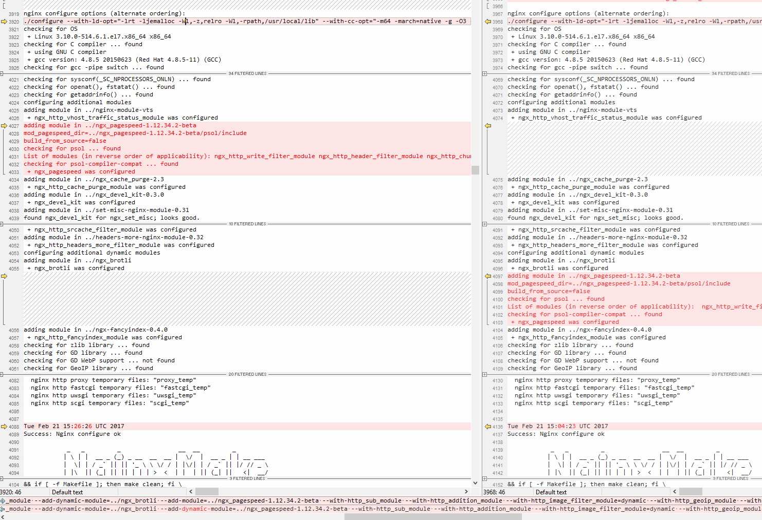

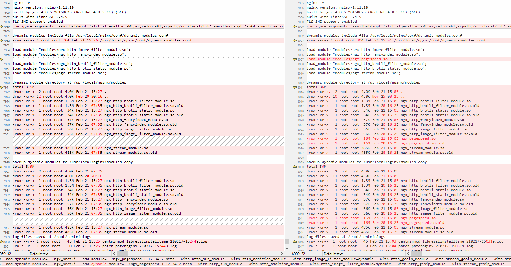

    also noticed some differences in paths between your latest nginx upgrade log and my working nginx upgrade log on centos 7.. are you using real full root user or did you setup a sudo user with root privileges ?
    also now that you have working nginx init.d enable ngx_pagespeed as a dynamic module in persistent config
    NGXDYNAMIC_NGXPAGESPEED='y'
    NGINX_PAGESPEED='y'
    probably why stripped nginx binary is still 14M in size :)
    left is your nginx upgrade log, right is mine
