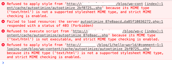

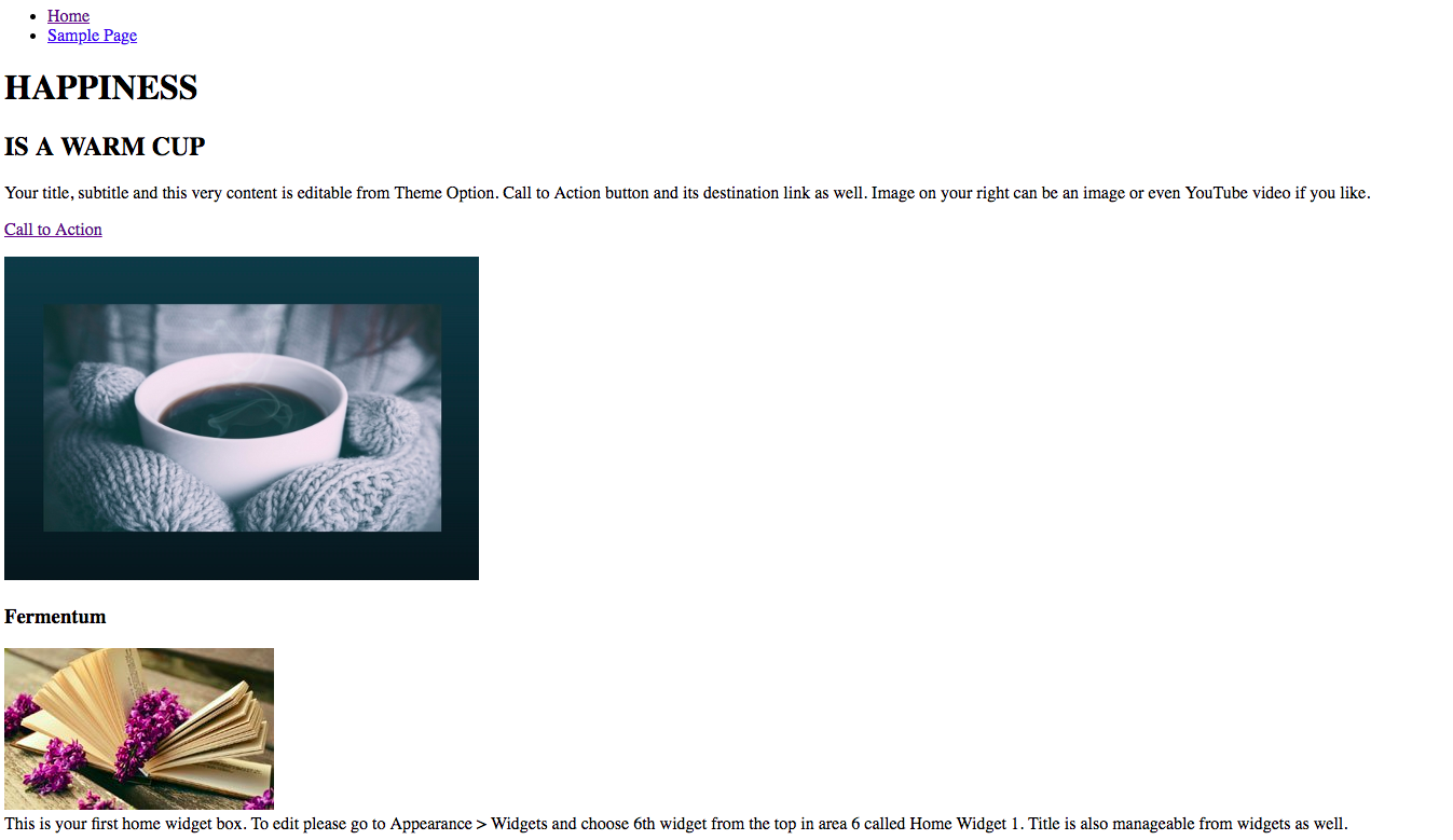

    Hello
    I installed my wordpress and I said yes to self signed ssl and the other admin options plus installing CDN, and choosed /blog to make the blog path www.mydomain.com/blog
    I found that the wordpress is installed but the theme lost images then I entered the admin panel and changed the link of the site in general setting to mydomain.com/blog ( i added /blog ) then the theme at the website worked 100% with images but all links inside the admin panel went down and not working. what is that issue ?
    Thanks :)

    When you create a new nginx vhost domain via centmin.sh menu option 2 or menu option 22 or via /usr/bin/nv cli command line, you will create the Nginx vhost files and directories. You will get an outputted the path location where it will create the domain name's vhost conf file named newdomain.com.conf (and newdomain.com.ssl.conf if you selected yes to self signed SSL)
    • Nginx vhost conf path will be at /usr/local/nginx/conf/conf.d/newdomain.com.conf
    • Nginx HTTP/2 SSL vhost conf path will be at /usr/local/nginx/conf/conf.d/newdomain.com.ssl.conf
    • Nginx Self-Signed SSL Certificate Directory at /usr/local/nginx/conf/ssl/newdomain.com
    • Vhost public web root will be at /home/nginx/domains/newdomain.com/public
    • Vhost log directory will be at /home/nginx/domains/newdomain.com/log
    Please post the contents of /usr/local/nginx/conf/conf.d/newdomain.com.conf and if applicable /usr/local/nginx/conf/conf.d/newdomain.com.ssl.conf wrapped in CODE tags (outlined at How to use forum BBCODE code tags)
    what is output of these commands in ssh
    curl -I https://domain.com/blog/
    curl -I https://www.domain.com/blog/
    curl -I http://domain.com/blog/
    curl -I http://www.domain.com/blog/
    wrap output in CODE tags

    your non-https 301 redirects are incorrectly redirecting to non-https versions of your site
    Posted at centminmod.com/nginx_domain_dns_setup.html#httpsredirect is the correct way to set it up - pay attention to different way if you want redirect target being www version instead of non-www and vice versa and that the target version www or non-www is the only version listed in server_name for the 2nd/main server {} context.
    key to testing is using 302 temp redirect first in a private incognito browser session otherwise the problems you can experience may end up being due to browser caching or 301 permanent redirects unless you clear browser cache and reboot local computer(s) and even then some web browsers don't let go of 301 permanent redirect browser cache that willingly :)
    edit you're behind cloudflare so no need other than do outlined change here Wordpress - down
    but your vhosts don't seem to be setup for /blog based wordpress install but for web root / based wordpress installs
    you can double check your nginx vhost creation log which is automatically saved when you run centmin.sh menu options at /root/centminlogs
    you can use this command to list the logs in data ascending order so last log is latest and use grep to filter display for only addvhost named logs
    ls -lahrt /root/centminlogs/ | grep addvhost
    you can download and inspect the log related to your domain to make sure you did choose /blog for subdirectory
    no need to share full log maybe just parts related to the initial questions and your inputs

    Hi
    Wordpress Setup:
    Set custom WP Admin Display Name ? [y/n]: y
    Enter Custom WP Admin Display Name: user
    Install Wordpress in subdirectory /blog ? [y/n]: yes
    Disable Auto Generated WP Admin Username / Password ? [y/n]: n
    Disable wp-login.php password protection ? (less security) [y/n]: n
    Enter email address for Admin User for Wordpress Installation: [email protected]
    This is the part of the /blog in the log ( my answer was "yes" not only "y". May that cause the issue ?
    how can I solve that, what the edits should be done ?
    #I don't have SSL till now so I made my cloudflare option "Flexible" till I install it and I will change it to "full"
    Thanks
    39,742
    8,765
    +13,486
    5:12 PM
    yup that's the problem answer suggestion is y or n not yes or no so it ignored the direction to install into /blog
    easiest way if you can is remove the nginx vhost and wordpress site and redo centmin.sh menu option 22
    Every centmin.sh menu option 22 run has an accompanying uninstall script at /root/tools/wp_uninstall_${vhostname}.sh where ${vhostname} = your domain name. You can run that to uninstall almost everything except mysql database which you have to manually remove yourself - extra precaution in case you accidentally run the worng uninstall script.

    I installed it and deleted the previous setup. All images are not shown but links are good. this chrome notification attached and cloudflare ssl is FULL ( I didnt install my ssl yes ).
    i attached the error @eva2000 :
