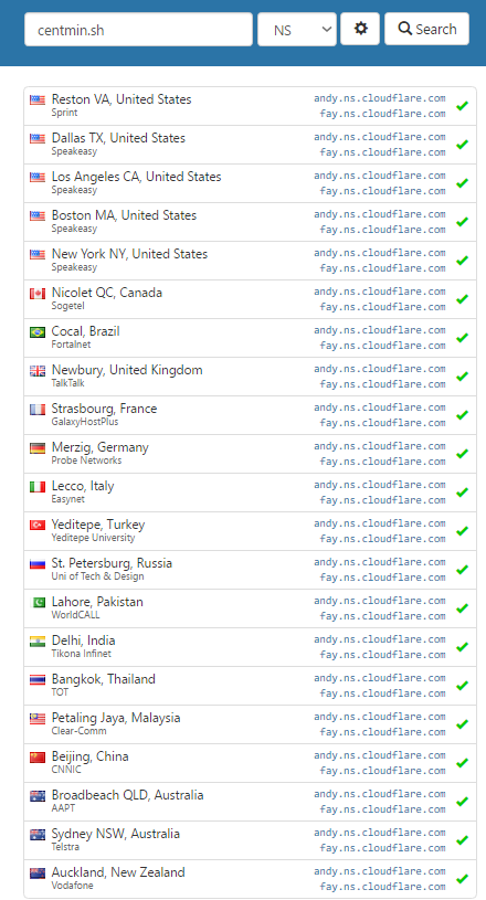

    if those ips are belonging to your servers and not cloudflare's ips, then ns1/ns2 are using your nameservers and not cloudflare's if i understand what you did
    use https://www.whatsmydns.net/ to confirm for NS record lookup
    only when your domain is using cloudflare's nameservers are you actually using cloudflare dns otherwise just adding domain to cloudflare isn't enough - as the domain's NS lookup needs to point to cloudflare's nameservers
    example centmin.sh domain uses cloudflare nameservers
