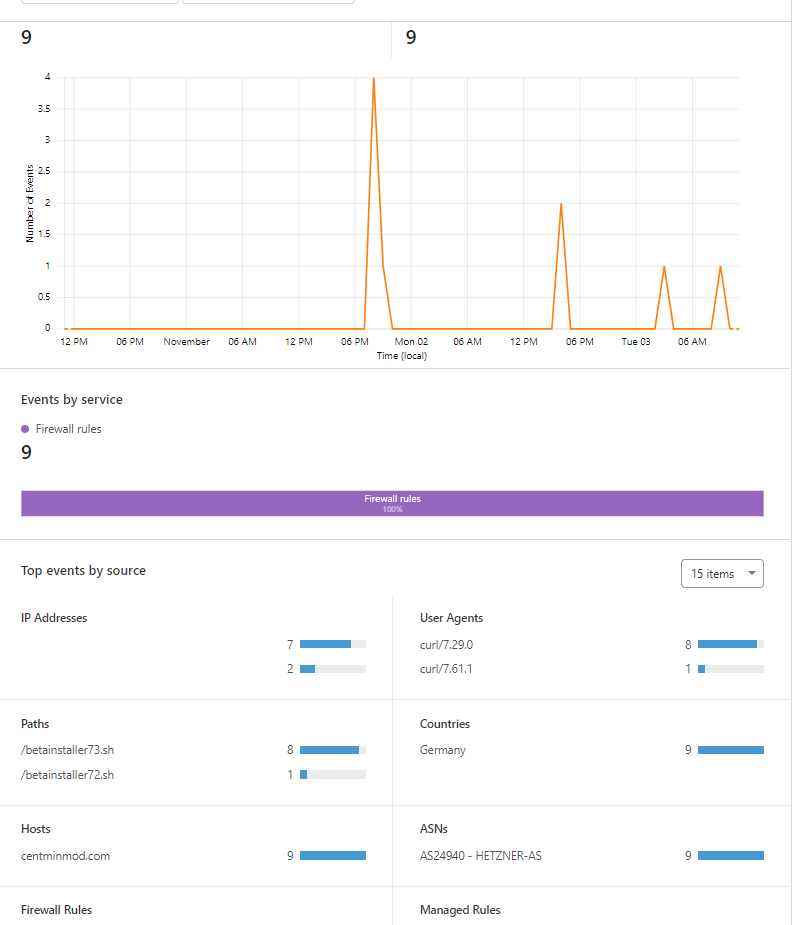

    Ah sorry you experienced such issues. I'll have to tune my centminmod.com Cloudflare Bot Management rules.
    Can you run this command on your server you tried installing Centmin Mod on
    curl -s https://ipinfo.io/org
    provide the output for this command so I can look up my Bot Managament Analytics logs to see what's up
    Also how are you installing Centmin Mod? exact SSH commands used ? As per official Install guide at Centmin Mod LEMP Stack Install Nginx on CentOS ?
    Also on captcha challenge page there would be a cf-ray or cf-request-id presented. Can you post that too so I can track your requests
    46,191
    10,501
    +16,281
    4:37 AM

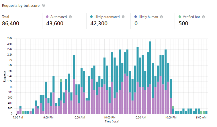

    I think I found it, it was a recently new CF Firewall rule I added to block a rogue bot crawler which was pushing 83,000+ requests to my forums and in accidentally caught some betainstaller73.sh and betainstaller72.sh requests I think that is yours on Hetzner hosting? You can try again now, I should have adjusted the CF Firewall rule now
    Cloudflare Firewall rule was meant to block this bot
