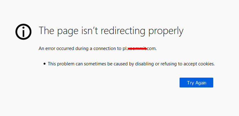

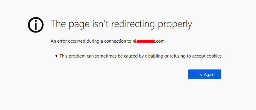

    Well, Did a new install on other subdomain, 22-1 and directly had the same issue, without that the wp-cli cron had time to execute. As you can see one is nl.domain.com where i changed the wp_updater, the other is pl.domain.com without any changes, not adding plugins, nothing. All other domains previous created load normal.
    The log can be found here
    install 22-1 redirection error
    41,292
    9,266
    +14,217
    2:21 AM
    letsencrypt ssl validation failed for your domain due to "Too many redirects" error so you have misconfigured cloudflare probably - don't set cloudflare http to https redirect if you use centmin mod nginx letsencrypt vhost creation with default https. As what happens is cloudflare flexible ssl connects to your origin non-https for requests but your origin centmin mod nginx is redirecting non-https to https - so you go around in circles, https requests on cloudflare end getting redirected back to itself as centmin mod nginx origin is doing non-https to https redirects.

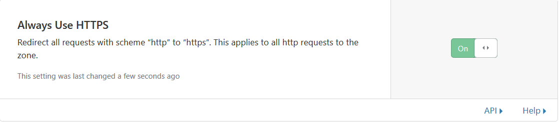

    Removed the pl.domain.com and did a new install. Seems to be fine after the adjusment on Cloudflare. Project_CMM_7244.png
    41,292
    9,266
    +14,217
    2:21 AM
    yes you can disable always use HTTPS if you use centmin mod nginx with default live HTTPS as nginx takes care of non-http to https redirects. If you enable always use HTTPS as well, you go around in a loop of cloudlfare redirecting users to HTTPS but connecting to origin centmin mod nginx via non-HTTPS in flexible SSL mode and then doing non-HTTPS to HTTPS redirect = too many redirects
