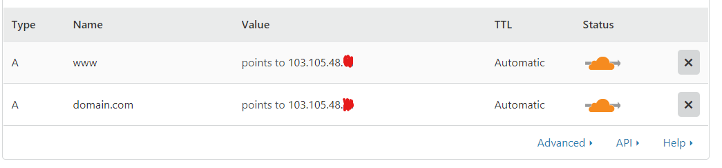

    As to letsencrypt cert if failed to issue/validate your domain and you have DNS issues - you are missing DNS A and if using IPv6 in nginx vhost you setup, also missing AAAA records for www version of your domain
    [Mon Mar 25 01:54:43 UTC 2019] Getting domain auth token for each domain
    [Mon Mar 25 01:54:45 UTC 2019] Getting webroot for domain='wasfitnet.com'
    [Mon Mar 25 01:54:45 UTC 2019] Getting webroot for domain='www.wasfitnet.com'
    [Mon Mar 25 01:54:45 UTC 2019] Verifying: wasfitnet.com
    [Mon Mar 25 01:54:48 UTC 2019] Success
    [Mon Mar 25 01:54:48 UTC 2019] Verifying: www.wasfitnet.com
    [Mon Mar 25 01:54:51 UTC 2019] www.wasfitnet.com:Verify error:dns :: DNS problem: NXDOMAIN looking up A for www.wasfitnet.com
    [Mon Mar 25 01:54:51 UTC 2019] Please check log file for more details: /root/centminlogs/acmetool.sh-debug-log-250319-014847.log
    LECHECK = 1
    if not using IPv6 listeners in nginx vhost, remove any AAAA IPv6 DNS records from your domain and www version of domain.
    then try acmetool.sh add reissue-only option
