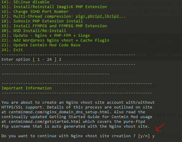

    so I don't know what happen but I'm little annoyed by this.
    So maybe after update something that I don't know.
    centmin ask new question every creating new vhost like this :
    but there's no problem on there.. but on photo below..

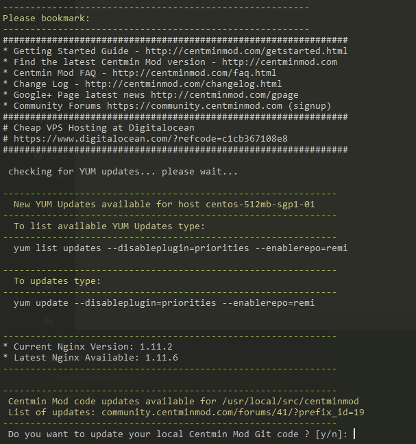

    after exiting centmin. centmin always asking for update.. I already tried to update but the version still same and centmin still ask for update and It take long time for this.. so I really annoyed by that..
    is there a problem with my centmin? is there any way to remove that (2nd sceenshot)?
    if that change for good can you tell me what the function about that both screenshot ?

    123.09beta01 is continuously updated, i.e. today i made at least 3 separate updates :)
    you can confirm manually if there is updates or not via ssh commands below
    cd /usr/local/src/centminmod
    git stash
    git pull
    that is the ssh manual equivalent of centmin.sh menu option 23 submenu option 2 or the exit centmin.sh prompted update code.

    The version is still the same, @eva2000 does small code commits which is why you are seeing updates available.
    43,092
    9,782
    +15,103
    6:44 AM
    oh yes if @chorong91 means 123.09beta01 version number that is the same it's just code commits updated within same branch version.
    example of 123.09beta01 commit history updates by date at Commits · centminmod/centminmod · GitHub
