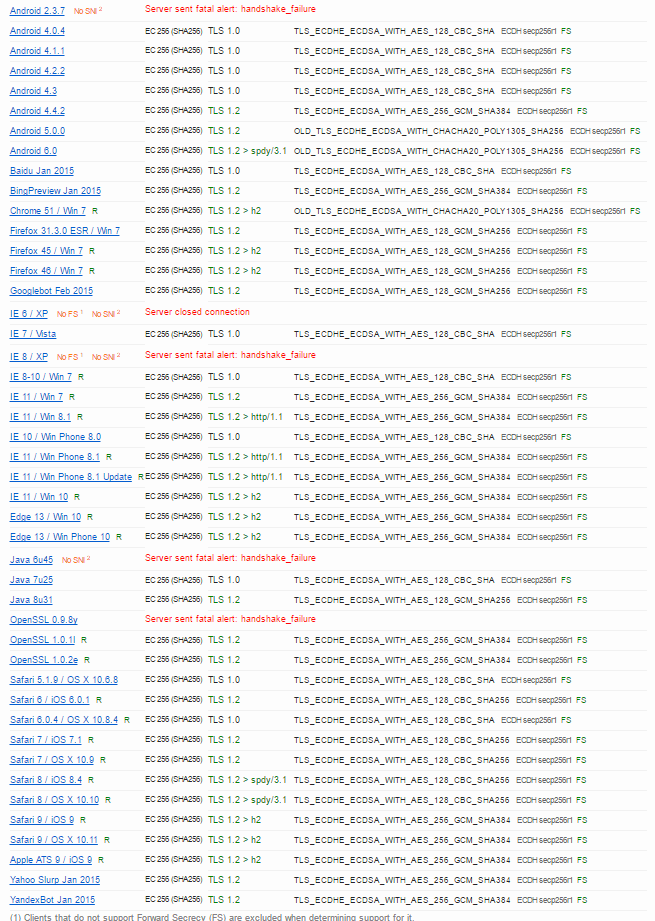

    Live Nginx HTTP/2 + SPDY Testing
    Doing live testing of Centmin Mod 123.09beta01's Nginx 1.11.1 with HTTP/2 + SPDY patch at sslspdy.com
    echo QUIT | openssl s_client -connect sslspdy.com:443 -nextprotoneg ' ' 2>&1 | grep 'Protocols advertised'
    Protocols advertised by server: h2, spdy/3.1, http/1.1
    is-http2 tool test
    is-http2 https://sslspdy.com
    ✓ HTTP/2 supported by https://sslspdy.com
    Supported protocols: h2 spdy/3.1 http/1.1
    curl
    curl -Ivs https://sslspdy.com
    * Rebuilt URL to: https://sslspdy.com/
    *   Trying 192.184.89.66...
    * Connected to sslspdy.com (192.184.89.66) port 443 (#0)
    * ALPN, offering h2
    * ALPN, offering http/1.1
    nghttp2 client
     nghttp -nav https://sslspdy.com
    [  0.109] Connected
    The negotiated protocol: h2
    [  0.252] send SETTINGS frame <length=12, flags=0x00, stream_id=0>
              (niv=2)
              [SETTINGS_MAX_CONCURRENT_STREAMS(0x03):100]
              [SETTINGS_INITIAL_WINDOW_SIZE(0x04):65535]

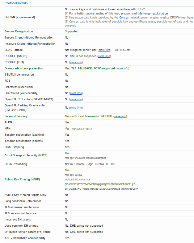

    testssl test - notice the protocol's tested include spdy/3.1 and NPN and h2
    testssl https://sslspdy.com
        testssl       2.7dev from https://testssl.sh/dev/
        (1.502 2016/06/15 19:31:09)
          This program is free software. Distribution and
                 modification under GPLv2 permitted.
          USAGE w/o ANY WARRANTY. USE IT AT YOUR OWN RISK!
           Please file bugs @ https://testssl.sh/bugs/
    Testing protocols (via sockets except TLS 1.2, SPDY+HTTP2)
    SSLv2      not offered (OK)
    SSLv3      not offered (OK)
    TLS 1      offered
    TLS 1.1    offered
    TLS 1.2    offered (OK)
    SPDY/NPN   h2, spdy/3.1, http/1.1 (advertised)
    HTTP2/ALPN h2, spdy/3.1, http/1.1 (offered)
    Testing ~standard cipher lists
    Null Ciphers                 not offered (OK)
    Anonymous NULL Ciphers       not offered (OK)
    Anonymous DH Ciphers         not offered (OK)
    40 Bit encryption            not offered (OK)
    56 Bit encryption            not offered (OK)
    Export Ciphers (general)     not offered (OK)
    Low (<=64 Bit)               not offered (OK)
    DES Ciphers                  not offered (OK)
    Medium grade encryption      not offered (OK)
    Triple DES Ciphers           not offered (OK)
    High grade encryption        offered (OK)
    Testing robust (perfect) forward secrecy, (P)FS -- omitting Null Authentication/Encryption as well as 3DES and RC4 here
    PFS is offered (OK)  ECDHE-ECDSA-AES256-GCM-SHA384 ECDHE-ECDSA-AES256-SHA384 ECDHE-ECDSA-AES128-GCM-SHA256 ECDHE-ECDSA-AES128-SHA256 ECDHE-ECDSA-AES128-SHA
    Testing server preferences
    Has server cipher order?     yes (OK)
    Negotiated protocol          TLSv1.2
    Negotiated cipher            OLD-ECDHE-ECDSA-CHACHA20-POLY1305, 256 bit ECDH
    Cipher order
        TLSv1:     ECDHE-ECDSA-AES128-SHA
        TLSv1.1:   ECDHE-ECDSA-AES128-SHA
        TLSv1.2:   OLD-ECDHE-ECDSA-CHACHA20-POLY1305 ECDHE-ECDSA-AES256-GCM-SHA384 ECDHE-ECDSA-AES128-GCM-SHA256 ECDHE-ECDSA-AES128-SHA256 ECDHE-ECDSA-AES256-SHA384 ECDHE-ECDSA-AES128-SHA
        h2:        OLD-ECDHE-ECDSA-CHACHA20-POLY1305
        spdy/3.1:  OLD-ECDHE-ECDSA-CHACHA20-POLY1305
        http/1.1:  OLD-ECDHE-ECDSA-CHACHA20-POLY1305
    Testing server defaults (Server Hello)
    TLS extensions (standard)    "renegotiation info/#65281" "EC point formats/#11" "session ticket/#35" "status request/#5" "next protocol/#13172"
    Session Tickets RFC 5077     600 seconds (PFS requires session ticket keys to be rotated <= daily)
    SSL Session ID support       yes
    TLS clock skew               random values, no fingerprinting possible
    Signature Algorithm          ECDSA with SHA256
    Server key size              ECDSA 256 bits
    Fingerprint / Serial         SHA1 155AA462E9EBFC2C608D18AB83DD32C17245C89A / 6F2CECA22E73F3FFA5266435705B5390
                                  SHA256 91A3930E8F38C7B1EBBC265953B8773E888544BD7C45F5A6927AF50D80D31C11
    Common Name (CN)             "*.sslspdy.com" (wildcard certificate match) (works w/o SNI)
    subjectAltName (SAN)         "*.sslspdy.com" "sslspdy.com"
    Issuer                       "COMODO ECC Domain Validation Secure Server CA" ("COMODO CA Limited" from "GB")
    EV cert (experimental)       no
    Certificate Expiration       123 >= 60 days (2014-10-24 00:00 --> 2016-10-23 23:59 +0000)
    # of certificates provided   3
    Chain of trust (experim.)    "/usr/bin/etc/*.pem" cannot be found / not readable
    Certificate Revocation List  http://crl.comodoca.com/COMODOECCDomainValidationSecureServerCA.crl
    OCSP URI                     http://ocsp.comodoca.com
    OCSP stapling                offered
    Testing HTTP header response @ "/"
    HTTP Status Code             200 OK
    HTTP clock skew              -1464583848 sec from localtime
    Strict Transport Security    365 days=31536000 s, includeSubDomains
    Public Key Pinning           # of keys: 2, 604800 s = 7 days (<30 days is not good enough), includeSubDomains
                                  matching host key: QYBZo54E74EGPmprgubrqe39L01K0kkNQBfJ6hRFUyE
    Server banner                nginx centminmod
    Application banner           X-Powered-By: centminmod
    Cookie(s)                    (none issued at "/")
    Security headers             --
    Reverse Proxy banner         --
    Testing vulnerabilities
    Heartbleed (CVE-2014-0160)                not vulnerable (OK) (no heartbeat extension)
    CCS (CVE-2014-0224)                       not vulnerable (OK)
    Secure Renegotiation (CVE-2009-3555)      not vulnerable (OK)
    Secure Client-Initiated Renegotiation     not vulnerable (OK)
    CRIME, TLS (CVE-2012-4929)                not vulnerable (OK)
    BREACH (CVE-2013-3587)                    potentially NOT ok, uses gzip HTTP compression. - only supplied "/" tested
                                               Can be ignored for static pages or if no secrets in the page
    POODLE, SSL (CVE-2014-3566)               not vulnerable (OK)
    TLS_FALLBACK_SCSV (RFC 7507), experim.    Downgrade attack prevention supported (OK)
    FREAK (CVE-2015-0204)                     not vulnerable (OK)
    DROWN (2016-0800, CVE-2016-0703), exper.  not vulnerable on this port (OK)
                                               make sure you don't use this certificate elsewhere with SSLv2 enabled services
                                               https://censys.io/ipv4?q=91A3930E8F38C7B1EBBC265953B8773E888544BD7C45F5A6927AF50D80D31C11 could help you to find out
    LOGJAM (CVE-2015-4000), experimental      not vulnerable (OK), common primes not checked. See below for any DH ciphers + bit size
    BEAST (CVE-2011-3389)                     TLS1: ECDHE-ECDSA-AES128-SHA
                                               VULNERABLE -- but also supports higher protocols (possible mitigation): TLSv1.1 TLSv1.2
    RC4 (CVE-2013-2566, CVE-2015-2808)        no RC4 ciphers detected (OK)

    Running browser simulations (experimental)
    Android 2.3.7                 No connection
    Android 4.0.4                 TLSv1 ECDHE-ECDSA-AES128-SHA
    Android 4.1.1                 TLSv1 ECDHE-ECDSA-AES128-SHA
    Android 4.2.2                 TLSv1 ECDHE-ECDSA-AES128-SHA
    Android 4.3                   TLSv1.0 ECDHE-ECDSA-AES128-SHA
    Android 4.4.2                 TLSv1.1 ECDHE-ECDSA-AES128-SHA
    Android 5.0.0                 TLSv1.2 ECDHE-ECDSA-AES128-GCM-SHA256
    Baidu Jan 2015                TLSv1 ECDHE-ECDSA-AES128-SHA
    BingPreview Jan 2015          TLSv1.2 ECDHE-ECDSA-AES256-GCM-SHA384
    Chrome 47 / OSX               TLSv1.2 ECDHE-ECDSA-AES128-GCM-SHA256
    Firefox 31.3.0ESR / Win7      TLSv1.2 ECDHE-ECDSA-AES128-GCM-SHA256
    Firefox 42 / OSX              TLSv1.2 ECDHE-ECDSA-AES128-GCM-SHA256
    GoogleBot Feb 2015            TLSv1.2 ECDHE-ECDSA-AES128-GCM-SHA256
    IE6 / XP                      No connection
    IE7 / Vista                   TLSv1.0 ECDHE-ECDSA-AES128-SHA
    IE8 / XP                      No connection
    IE8-10 / Win7                 TLSv1.0 ECDHE-ECDSA-AES128-SHA
    IE11 / Win7                   TLSv1.2 ECDHE-ECDSA-AES256-GCM-SHA384
    IE11 / Win8.1                 TLSv1.2 ECDHE-ECDSA-AES256-GCM-SHA384
    IE10 / Win Phone 8.0          TLSv1.0 ECDHE-ECDSA-AES128-SHA
    IE11 / Win Phone 8.1          TLSv1.2 ECDHE-ECDSA-AES256-GCM-SHA384
    IE11 / Win Phone 8.1 Update   TLSv1.2 ECDHE-ECDSA-AES256-GCM-SHA384
    IE11 / Win10                  TLSv1.2 ECDHE-ECDSA-AES256-GCM-SHA384
    Edge 13 / Win10               TLSv1.2 ECDHE-ECDSA-AES256-GCM-SHA384
    Edge 12 / Win Phone 10        TLSv1.2 ECDHE-ECDSA-AES256-GCM-SHA384
    Java 6u45                     No connection
    Java 7u25                     TLSv1 ECDHE-ECDSA-AES128-SHA
    Java 8u31                     TLSv1.2 ECDHE-ECDSA-AES128-GCM-SHA256
    OpenSSL 0.9.8y                No connection
    OpenSSL 1.0.1l                TLSv1.2 ECDHE-ECDSA-AES256-GCM-SHA384
    OpenSSL 1.0.2e                TLSv1.2 ECDHE-ECDSA-AES256-GCM-SHA384
    Safari 5.1.9/ OSX 10.6.8      TLSv1 ECDHE-ECDSA-AES128-SHA
    Safari 6 / iOS 6.0.1          TLSv1.2 ECDHE-ECDSA-AES128-SHA256
    Safari 6.0.4/ OS X 10.8.4     TLSv1 ECDHE-ECDSA-AES128-SHA
    Safari 7 / iOS 7.1            TLSv1.2 ECDHE-ECDSA-AES128-SHA256
    Safari 7 / OS X 10.9          TLSv1.2 ECDHE-ECDSA-AES128-SHA256
    Safari 8 / iOS 8.4            TLSv1.2 ECDHE-ECDSA-AES128-SHA256
    Safari 8 / OS X 10.10         TLSv1.2 ECDHE-ECDSA-AES128-SHA256
    Safari 9 / iOS 9              TLSv1.2 ECDHE-ECDSA-AES256-GCM-SHA384
    Safari 9 / OS X 10.11         TLSv1.2 ECDHE-ECDSA-AES256-GCM-SHA384
    SSLLabs test reports NPN and SPDY/3.1 support + ALPN and HTTP/2 support

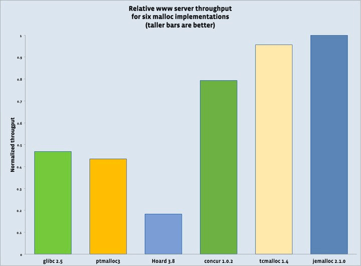

    You can tell if Google perftools enabled tcmalloc has replaced glibc malloc and is in use by nginx via command
    lsof -n | grep tcmalloc
    example output
    nginx     22447   nginx   17w      REG                7,0         0         16 /tmp/tcmalloc.22447
    nginx     22448   nginx   19w      REG                7,0         0         17 /tmp/tcmalloc.22448
    However, you should not need to enable this as Centmin Mod 123.09beta01 installed nginx server uses jemalloc instead of usual default glibc malloc (as does MariaDB mysql server).
    lsof -n | grep jemalloc
    mysqld     1832   mysql  mem       REG              253,0    210024      21272 /usr/lib64/libjemalloc.so.1
    nginx     22446    root  mem       REG              253,0    210024      21272 /usr/lib64/libjemalloc.so.1
    nginx     22447   nginx  mem       REG              253,0    210024      21272 /usr/lib64/libjemalloc.so.1
    nginx     22448   nginx  mem       REG              253,0    210024      21272 /usr/lib64/libjemalloc.so.1
    You can read up about performance benefits of jemalloc over glibc malloc and tcmalloc in article posted by Facebook at Scalable memory allocation using jemalloc
    As you can see, Centmin Mod installed Nginx server is no ordinary Nginx build (jemalloc vs malloc) ;) :D
