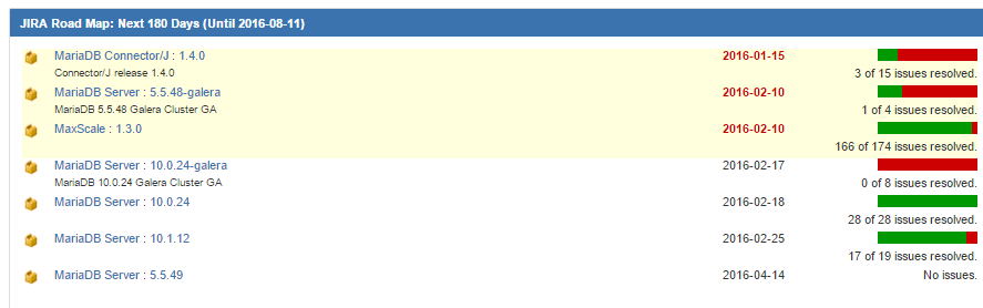

    Hmm if i can wait it out to Feb 25th (another 12+ days), maybe MariaDB 10.1.12 can be default for Centmin Mod 123.09stable ?
