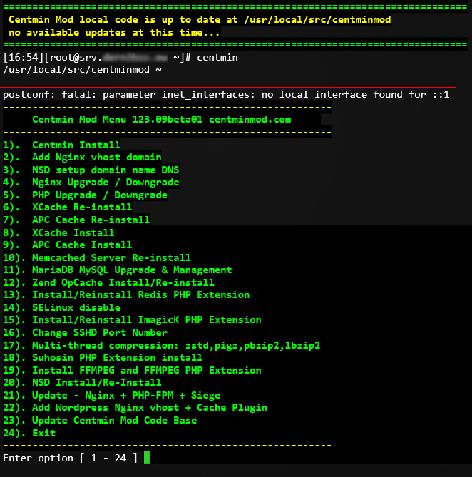

  11. JoeDer
    JoeDer Premium Member Premium Member
    45
    11
    Feb 22, 2015
    +31
    5:02 PM
    Hetzner Cloud CX11
    https://pastebin.com/raw/YvqJAFPC
    Input: cat /proc/sys/net/ipv6/conf/all/disable_ipv6
    Output: 1
    Input: postconf -n inet_protocols
    Output: postconf: fatal: parameter inet_interfaces: no local interface found for ::1
    Input: ping6 -c4 google.com
    Output: connect: Network is unreachable
    Added DISABLE_IPVSIX='y' in /etc/centminmod/custom_config.inc then I run centmin.sh menu and exit centmin.sh menu and I reboot the server but nothing changed.
    39,815
    8,780
    +13,515
    12:02 AM
    i'd contact web host to check if IPv6 connectivity is working

    39,815
    8,780
    +13,515
    12:02 AM
    ::1 my.host.name my
    Remove this entry does it have valid DNS AAAA ipv6 address record? You have similar problem as @Itworx4me both have set /etc/hosts abd the main hostname to same subdomain but probably have incorrect DNS records not pointing to centmin mod server's ip address
