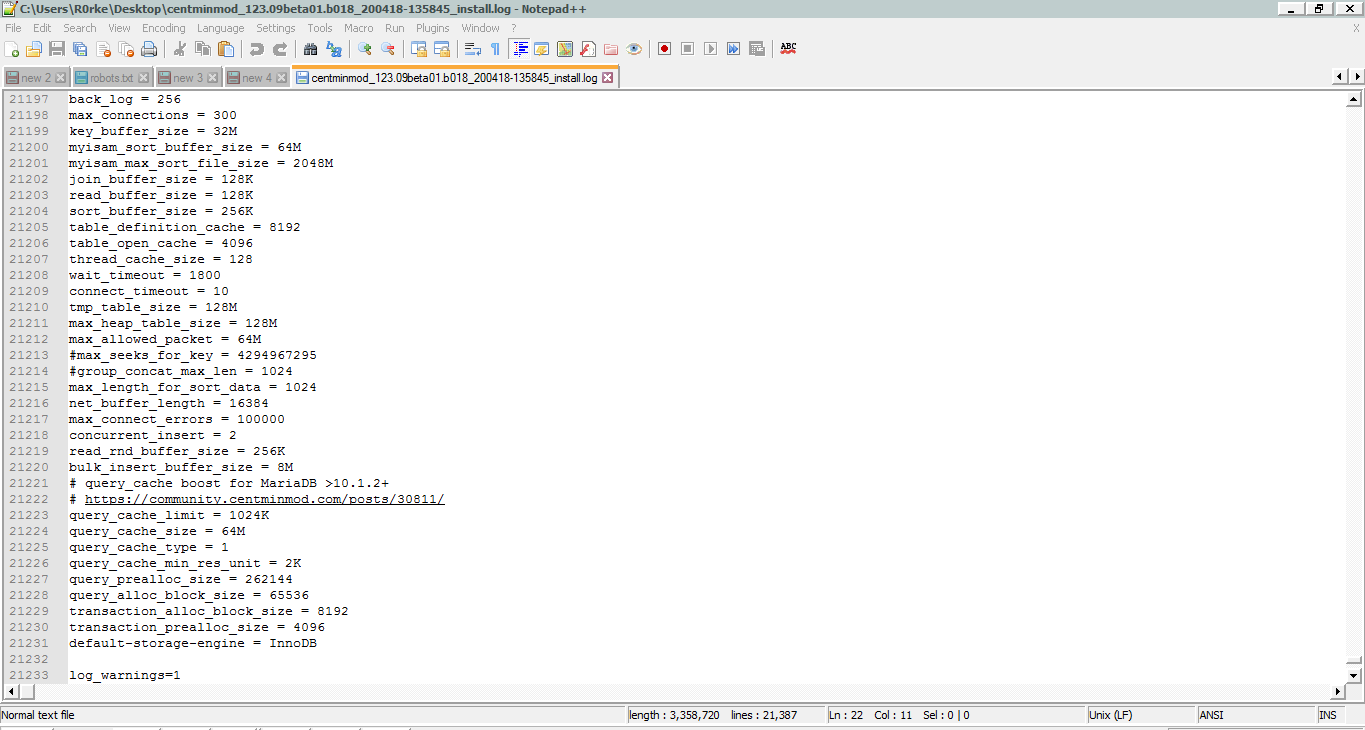

    FYI, your centminmod_123.09beta01.b018_200418-135845_install.log log is still just a bunch of numbers for me unfortunately
    try doing this instead just compress the install log and upload that
    cd /root/centminlogs
    pxz -k centminmod_123.09beta01.b018_200418-135845_install.log
    then upload the resulting centminmod_123.09beta01.b018_200418-135845_install.log.xz compressed log via 3rd party file service
    also verify on server the last 20 lines of the file using command to see if there's actual text there instead of just a bunch of random numbers
    tail -20 /root/centminlogs/centminmod_123.09beta01.b018_200418-135845_install.log

    don't know whats wrong with the logs because i can check them without any numbers or what ..

    37,697
    8,250
    +12,703
    12:59 AM
    You may want to try installing centmin mod on different server.
    But if you are opening log files with editor are saving them with utf8 encoding as unix/linux files? That is probably what is messing up the log file ?
    But does look like network ip config is using local private lan ip so yeah you would have difficulty accessing the servers site via public ip.

    this is the main file without any changes and no charset settings just normally downloaded and upload to github from my server .
    centminmod
    or
    https://gist.githubusercontent.com/SpaCheL3n3s/71a0cba5f30a2411c001e7144fbe65d3/raw/f9b5a35870577d1f1657b100581134e666869de1/centminmod-install-logs
    right now i don't have access to another server because they are busy
    so how can i config my network settings normal ?
    any tips or guide ?

    37,697
    8,250
    +12,703
    12:59 AM
    You'll have to ask your web host as they would best know their own networking configuration
    still the same not complete and with random number characters. It could also be due to your SSH client's encoding settings, make sure you use UTF-8 for SSH client app's encoding too. If you have a non-English language local PC it could introduce character encoding differences if your SSH client is set to use your PC's native encoding instead of UTF-8.
    Also it maybe incomplete as the log is too long if you used cat command to concatenate and output to SSH window. If you use Putty SSH client or another SSH client, for best Centmin Mod experience set your windows setting configuration to at least 160 columns, 70 rows and 256000 scrollback buffer size. The larger scrollback buffer size allows more lines to be displayed.
