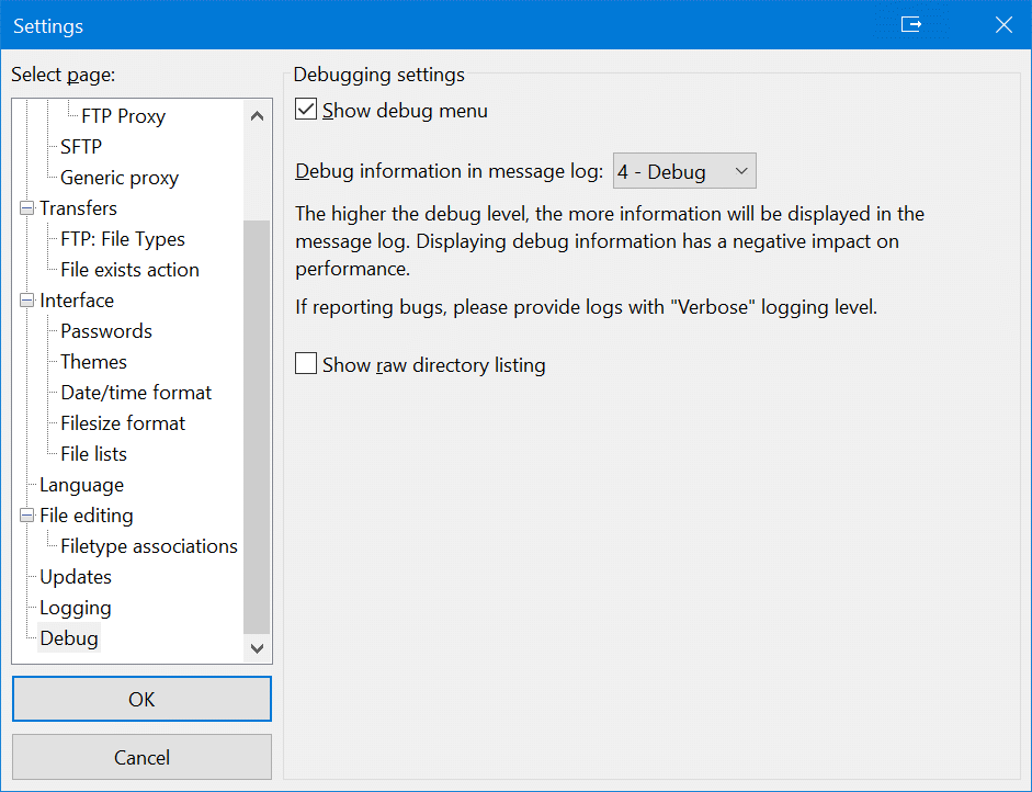

    For pure-ftpd virtual FTP password it would be instructions at Pure-FTPD Virtual FTP Users - CentminMod.com LEMP Nginx web stack for CentOS. If Transmit has verbose debug logs, enable them to see what is happening when you attempt to FTP log in
    For root user SFTP, that is just your root user password so if you can SSH into the server, you should be able to use SFTP. If you can't SSH in as root user, then look at Transmit client settings like TLS cipher/Key exchange etc.
