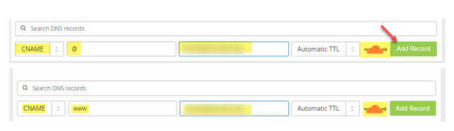

    Are you able to toggle the cloud icon on and off? Screen Shot 2019-10-10 at 6.53.40 PM.png

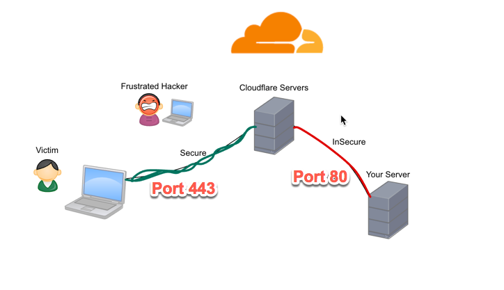

    When your configuration is set to Authenticated Origin Pulls restricted to the Cloudflare network you aren't going to be able to proxy off and have it return anything but 400.
    Once again since Cloudflare gets in between the client request and your server, they are able to provide you with what's called a "flexible SSL". This means that the traffic is secure/encrypted between the visitor and Cloudflare's servers, but then they send the request to your server over http (port 80) which is insecure. While this doesn't guarantee 100% secure communication. The good thing is that most of the time the man in the middle type attack occurs by a hacker intercepting the data going to and from the client. Not data that is being transferred from server to server.
    That's the explanation I got while finding this cute diagram.
