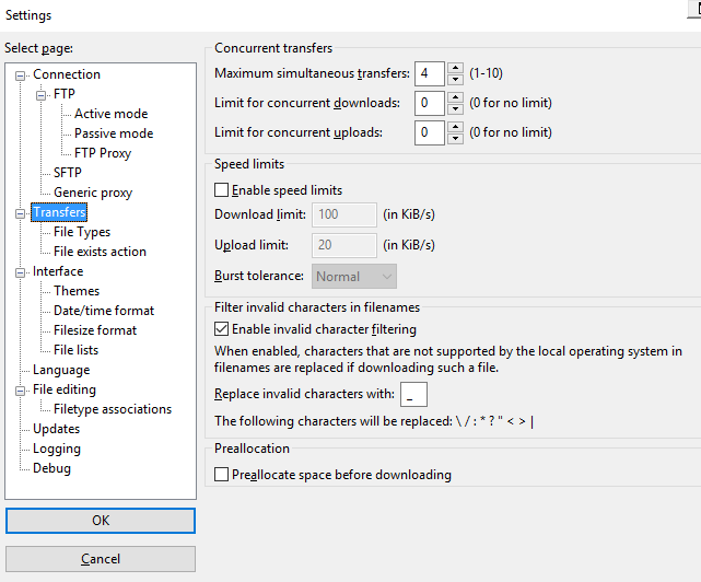

    it could be due to how your users FTP clients connect/transmit data i.e. opening too many simultaneous connections/transfer sessions at one time i.e. Filezilla's settings for simultaneous transfers and concurrent download/uploads don't set too high
    you can count them when your users are all logged into FTP doing download/uploads, via ssh command
    netstat -plantu | grep YOURISP_IPADDRESS | wc -l

    then you should go through all the troubleshooting in this thread for them too. Is this same group of user who had problems or different group ? and different server ? Make sure the fixed TCP setting is in place on this different server too
    2:57 AM
    also which ftp clients apps they using ? have you tried different ones ? wincp, filezilla, cuteftp, cyberduck ?
