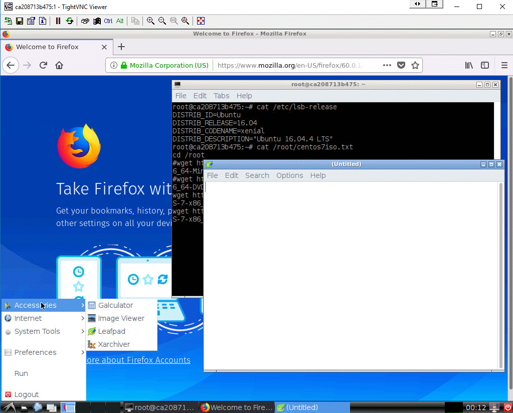

    You can setup remote desktop like server via VNC - though speed will highly depend on geographical distance and thus network latency from VPS to your location. So you'd want VPS to be in a geographical location closer to yourself. Search for CentOS 7 + VNC on Google.
    For example How to Install and Configure VNC Server in CentOS 7 just instead of using firewalld, you'd need to whitelist port 5901 via CSF Firewall's TCP_IN and TCP6_IN comma separated list of ports in /etc/csf/csf.conf and restart CSF Firewall and LFD (csf -ra) CSF Firewall - CentminMod.com LEMP Nginx web stack for CentOS
    I'd test a disposal test CentOS 7 server first to make sure you are familiar first.
    If you don't need CentOS or familiar with other OSes and Docker, you can install Docker VNC images on CentOS server. For example I have forked Ubuntu VNC docker image at centminmod/docker-ubuntu-vnc-desktop
