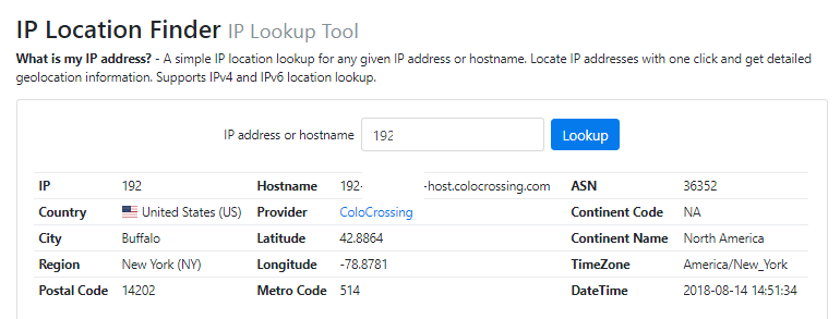

    Ah there's the problem you're getting 403 permission denied when connecting to
    https://centminmod.com/betainstaller72.sh so can't download it. Cloudflare probably flagged your server IP for some reason.
    < HTTP/1.1 403 Forbidden
    You can contact me via private conversation and provide your server's IP address and I will see Cloudflare has it blocked
    42,760
    9,679
    +14,934
    4:17 PM
    From IP you provided for your server, I checked my local CSF Firewall and no bans, nothing record in Cloudflare firewall bans so it could be higher up in Cloudflare's WAF that it banning your server IP for some reason. I quick google search for your server IP shows alot of spam tool check references to your IP, so maybe in the past the IP had some spam blacklisting ? It seems the IP is clean now though from spam black list checker.
    But your server IP does belong to colocrossing which has alot of spam reports - so much so some networks actually ban all colocrossing IP ranges from their network ! Seems your IP's IP range is listed in Spamhaus database in the past The Spamhaus Project - SBL
    cropped out your full IP address
    Who is your web host ? where is the server geographically located ? If it's a cloud VPS provider, maybe just spin up a different VPS with different IP and see if that helps. Unfortunately, really out of my control if Cloudflare considers the IP bad
    I'd advise avoiding web hosts who use colocrossing as alot of IPs will have been banned by various networks due to alot of spam activity on colocrossing's IP ranges.
