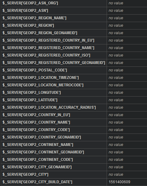

    With these setting on my new server it does not show the GEOPIP2 in the php.info file, on the old server it still gives the correct Geoip 2 info....:banghead::banghead::banghead:
    Currente time is 2:24AM, but need to diffcheck some more files to find out whats wrong, any ideas in the meantime are welcome!

    Yeah, did some testing with enable and disable, but noticed that you did not read completely the current setup as is in the post. First I got an error when removing the Hash, missing some city thing, but just changed my IP with a VPN to hide my real one and lost connection with the server, on reconnecting this info was gone.

    what's output for this command to do a diff compare and show only differences between the default php.conf include file and the php-geoip2.conf include file which has geoip2 lite fastcgi param variables you need to add to your php.conf manually as per Nginx - How to enable GeoIP 2 Lite Nginx Module Support ?
    sdiff -w200 -s /usr/local/nginx/conf/php.conf /usr/local/nginx/conf/php-geoip2.conf
    example shows php.conf missing the GEOIP2 mapping variables which php-geoip2.conf has - you need to manually add those into php.conf include file at /usr/local/nginx/conf/php.conf

    ah for your wordpress you'd need to add the fastcgi param into /usr/local/nginx/conf/php-wpsc.conf in your wordpress generated vhost config file not /usr/local/nginx/conf/php.conf
    • Winner Winner x 1
  8. EckyBrazzz
    857
    174
    +318
    9:31 PM
    Thanks, works instantly!
    Added all fastcgi param into /usr/local/nginx/conf/php-wpsc.conf and pronto.

    Out of the nothing the GeoIP 2 Stopped working, it was perfect until last night around 22:00 local time. I changed noting on the server.
    Now I get these values and my analytics showed the time that it did not capture anymore the correct data.

    Strange, after giving a "nprestart" it works again.
    43,424
    9,859
    +15,226
    10:31 AM
    maybe you caught it during cronjob geoip2 lite database update via /usr/local/src/centminmod/tools/geoip2db-update.sh ? though the script should do a nginx reload after update
    check the current geoip2 city build date reported, i.e. in screenshot it would be
    date -d @1561400609
    Mon Jun 24 18:23:29 UTC 2019
