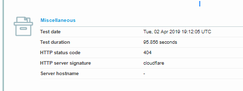

    Check they ssltest over cloudflare as you said: SSL Server Test: api.iugu.com (Powered by Qualys SSL Labs)
    I'm trying my best, but I don't know what happened.
    42,759
    9,679
    +14,934
    1:38 PM
    ssllabs reports 404 not found status code for the domain so the remotely hosted app is broken or not working or something
    probably need to contact that remotely hosted app's web site owner/web host to make sure it's working first

    SSL is working for the site but NOT for web app itself isn't as ssllabs report 404 not found
