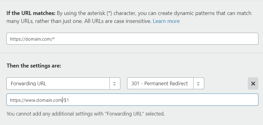

    Small tip that can save 500+ms for redirect request.
    Instead of doing your www/non-www redirect on the Server level,
    just do it on Cloudflare Page Rule Instead.
    Sample for www redirect
    My http to HTTPS redirect is already done by browser HSTS Preload List (local redirect 1ms).
    Test before and after via Browser Network Tab.
    With this option check

    I do have 65% of visitors that came from search engine and other site, still it helps for 1st time visitor.
    Or linked/bookmark url without www.
    That's why I don't include https redirect.

    Not my server but...
    User > Cloudflare > My Server > back to Cloudflare > to User = Takes 600-700+ms usually.
    Without cache/First time visitor.

    With this implementation, I only got:
    User > Cloudflare > back to User = Takes 40-150 ms usually.

    Nginx-1.17.x
    On your screenshot you are using https or is it as an example only?
    Or do you mean that you are not using it on the server?

    I mean I do not create/include HTTP to HTTPS redirect on Page Rule.
    As it's already taken care of by browser HSTS Preload List (local redirect 1ms).
